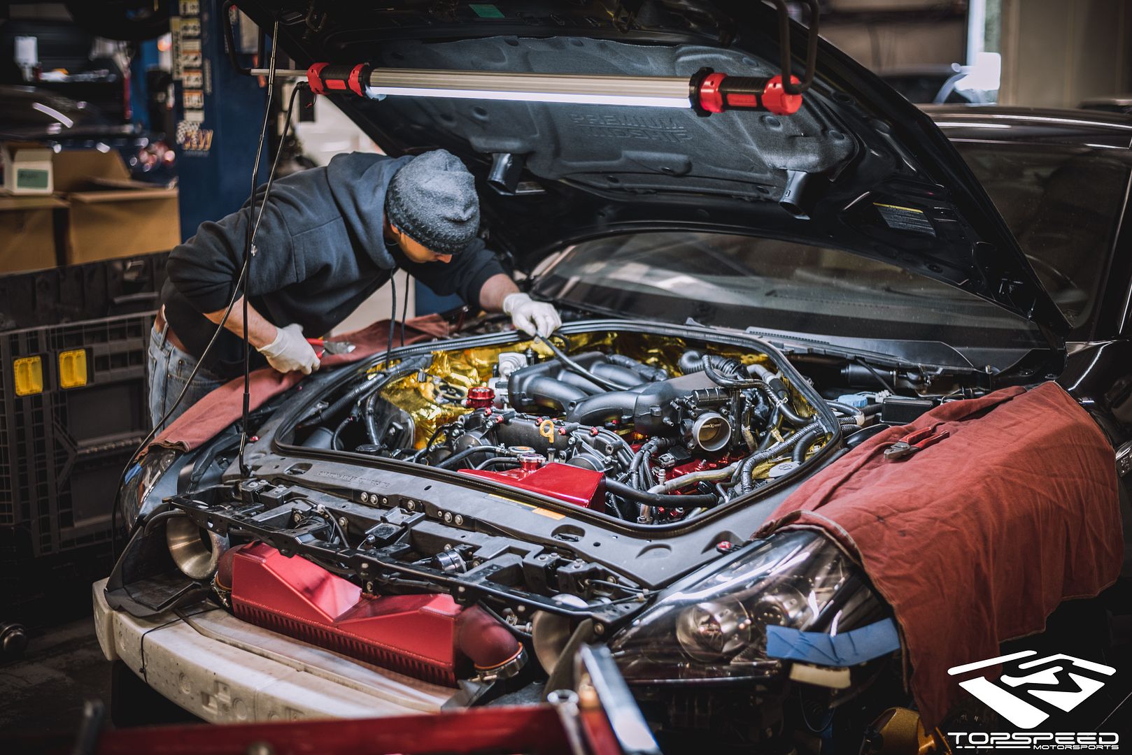

The car came in boxes…literally, but that was no issue. After some dividing, organizing, and sorting she was labeled and divided into build bins just like we would disassemble one of our own builds.

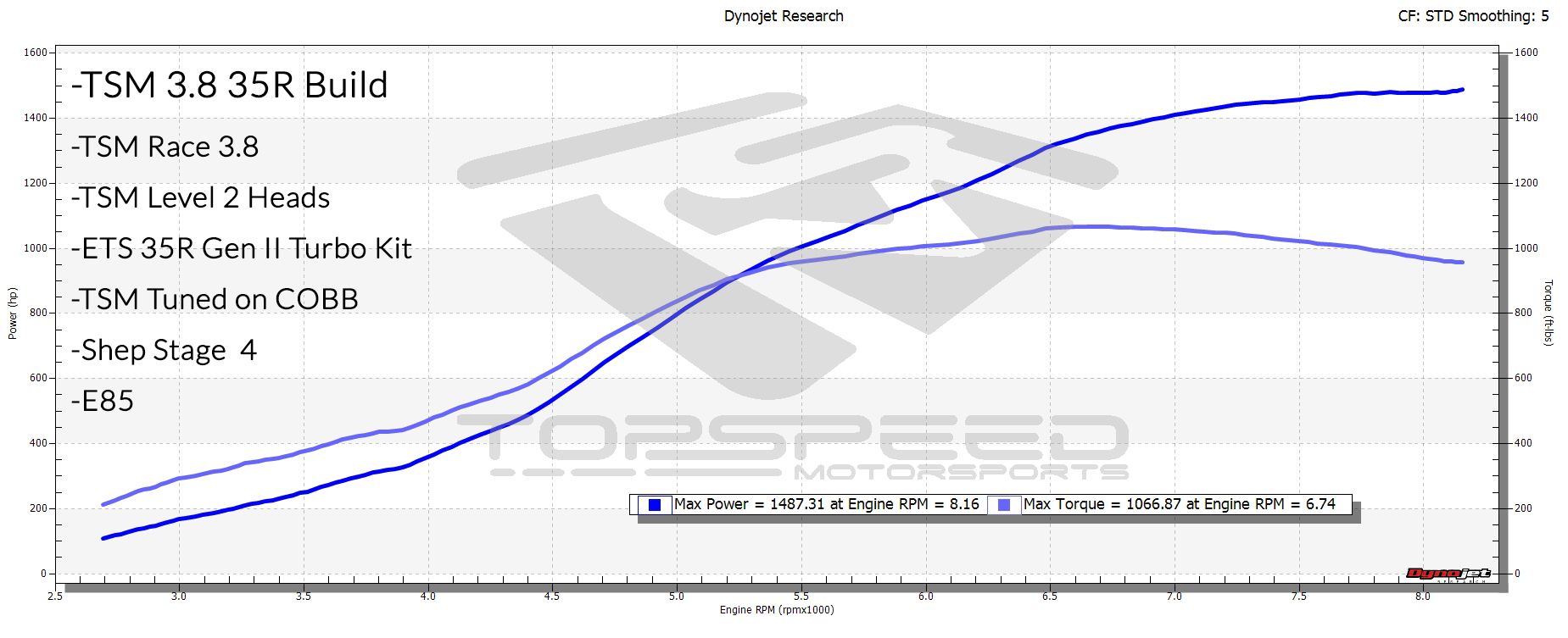

Tommy opted to upgrade to our Race 3.8 engine that is rated up to 1800hp instead of going back to a stock crank engine. The car already had an ETS 35r kit on it and the turbos had been compromised from the failure so an upgrade was in order. We decided to stick with a 35R so that the setup wasn’t too laggy to enjoy on the street but upgrade to the latest and greatest GTX on the existing ETS turbo kit.
For now the customer decided it wasn’t quite time to upgrade the fuel system so we stuck with the 6 injector on the factory ECU. He knew that this would limit the amount of power we could make but there are plans in the near future to upgrade to a Motec controlled 12 injector setup. Knowing that we were setting Tommy up to win with future upgrades we went with our ported heads, cams, and our proprietary wet sump oiling system to keep the bearings happy over the course of time at high HP.
The car went together without much issue, we were only missing a few parts from the previous shop but it didn’t slow us down. On the dyno the car performed really well. As I previously mentioned, we were power limited on Cobb with 6 injectors, but we pulled out all the little tricks to make the fuel system go as far as possible. Pump gas yielded just over 1080 HP and 790 TQ, which is about where we see most 35R cars. Honestly if the car is flex fuel we don’t see much reason to push pump gas to the limit. The fuel is rarely consistent and at those HP levels it doesn’t take much to get a couple strikes of detonation when pushing the very limits on pump. The risk simply isn’t worth the reward in our opinion. E85 however is a different story! With fuels like E and race gas’ that have much more octane the window gets much wider and safety margins increase exponentially. We were able to squeeze 1487 HP and 1067 TQ out of the fuel system on the ETS 35R setup!
